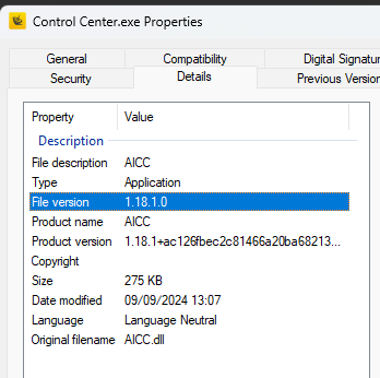

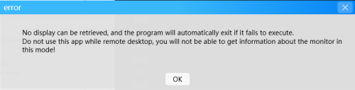

The Control Center application does not run when the display output is routed through the GPU on the EX Dock, or when using an external display dock connected via USB-C to the GTi 15 Ultra.
I can confirm that the Control Center works correctly when I connect an HDMI cable directly to the GTi 15 Ultra without using the EX Dock.
At the moment, the software appears unable to detect a display when using these dock configurations, which prevents it from launching. This is limiting, as there are several features within Control Center that I would still like to use, even when running my setup through the EX Dock or USB-C display dock.
I hope this can be addressed in a future update.
