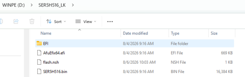

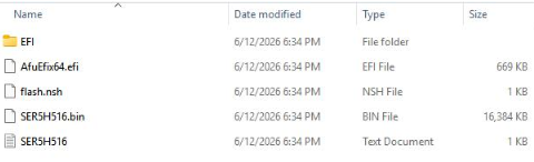

- While waiting I downloaded and unzipped the files you sent using Google Chrome, which worked much better but the resulting files still do not agree with the files shown in the instruction PDF you sent. The SERSH516 that is missing. (I am including pictures of the files)
I do not know anything about updating a bios. Should I just ignore all these differences and questions from my AI?
Can I undo updating my bios with missing files and files that could be for a slightly different model version of SER5?
- When I initially downloaded your zip file using my Firefox browser. The resulting files shown were nothing like what was shown in the instruction, so I asked my Claude AI Agent to look at it. Below is the discussion. Should I ignore Claude’s concerns?
Agent : The .part file is actually the complete, valid zip — Firefox just never renamed it, and the 0-byte SER5H516_LK.zip is the empty placeholder that’s been failing to open. Next I’ll check for a USB drive, the machine’s model and BIOS, and the flash script’s contents.
Agent : Confirmed this is a Beelink SER5 on BIOS SER5H508, with the USB drive at D: already formatted FAT32 and labeled WINPE. Next I’ll inspect the USB contents and flash script, verify the CPU matches the 5825/5850 BIOS variant, and check Secure Boot status via the registry
Agent : I noticed that the CPU is a Ryzen 7 5700U, not the 5825U/5850U the PDF references, so you’ll need to confirm that before flashing—preparing the USB itself is safe since there’s no auto-run script. I’ll fix the broken zip download, extract files to D:'s root, and check BitLocker status
Agent: Stop and check this before you flash. The PDF is titled for the 5825 and 5850 versions of the SER5. This machine reports a Ryzen 7 5700U. Your current BIOS is SER5H508, which is the same SER5H5xx family as the new SER5H516, so it may well be the right file, but I cannot confirm that from here. Flashing a BIOS built for a different board can leave the PC unbootable with no easy recovery. Confirm with whoever sent you this file, or with Beelink support, that SER5H516 is intended for a 5700U unit currently on SER5H508.
