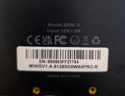

I’m attaching the Serial Number of the device here to speed up the process.
