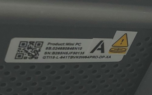

I have a Beelink GTi14, and after a recent Windows update, my Kinect v2 stopped working. In Device Manager, I now see a Generic SuperSpeed USB Hub with a yellow warning sign. The Kinect requires a stable Intel USB 3.x driver, and it appears that Windows has replaced my Intel driver with Microsoft’s generic one.
I already downloaded the official GTi14 Driver Pack (2024-07-10) from the forum. However, I couldn’t find a folder specifically labeled ‘USB’ inside the package. Could you please confirm:
Which folder in the GTi14 driver bundle contains the USB 3.x hub/host controller driver?
What is the correct installation order to make sure the chipset, SerialIO, and USB drivers install properly?
