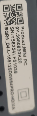

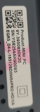

I’ll be uploading photos for both of their serial numbers, both of them are running the same BIOS version too, FP656V508
