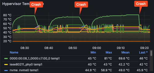

So I’ve been watching this thread and applied the Beelink 1.08 BIOS, Intel E610 1.30 firmware, built the ixgbe-6.2.5 drivers on CachyOS (kernel 6.17). And of course trying to use the Ethernet ports consistently resulted in NVM firmware crashes after a short period, so I decided to use the WiFi and wait patiently a little while longer for a fix.
That changed on Monday when the 10G network gear arrived and I really wanted to get it up and running, so decided to investigate the issue and found a solution that, for me at least, is reproducible and so far proving to be robust.
The issue strongly appears to manifest when the Ethernet controller/firmware cold boots. If an Ethernet port is linked during cold boot then the controller (memory) state is left buggy and will later cause instability and the NVM to crash, however if there is no link during cold boot initialization is correct (in this context at least) and the Ethernet link is stable.
After initial testing I’ve been running for a couple of days now non-stop without a single issue, I’m only using one port for now but since it’s stable I’ll order the hardware to cable the other port, hopefully given the nature of the fault using both ports won’t be an issue.
