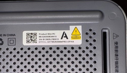

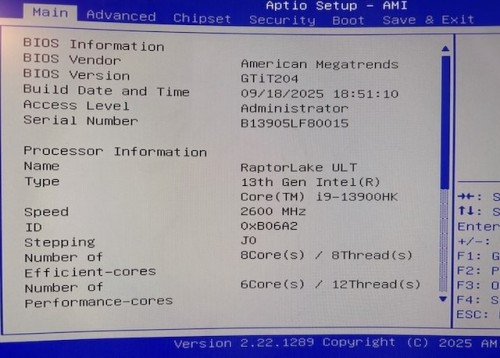

So I’ve attached what was asked for.
I am running the Zotac 5060ti
I did confirm that for Chipset -> System Agent (SA) Configuration -> PCI Express Configuration -> PCI Express Root Port 2 -> PCIe Speed was set to Gen4.
Issue continued. So just in case I tool all three root ports to Gen4. Still no joy.
