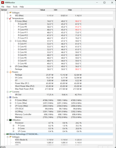

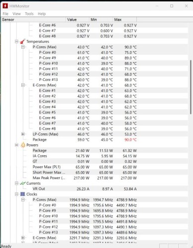

BLindsey I am having the same problem. I have been working with “bakahk” on the forum since early October. I supplied everything he asked. Still hot at idle. He quit replying October 30th. no response to my last entry. The following is a link to my support thread. https://bbs.bee-link.com/d/8236-gti14-cpu-very-high-temperatures-at-idle These are the screenshots and files I sent him. hwmonitor-idle-no-dock-horz.zip8kB hwmonitor-idle.zip9kB Please reply Thanks
